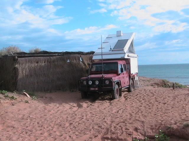

    David
    Our roof in on the camper which we take off the defender when not travelling....we hinged it that way so we could carry our solar panel and also put "stuff" on top if we needed to
    here is a pick
    Mrs ho har
