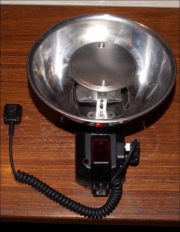

    Last Sunday in 'Arts and Craft' I made..
    ..this!
    It's called a 'beauty dish'. It just fits over the head of my flash gun and makes lighting like this..
    and this..
    .and this.
    Basically it came about after a 7" stainless steel mixing bowl became redundant when I bought the missus a complete new set for her birthday. Using a Milo tin lid, a crappy stubby holder and some unwanted kid's mechano bits, the design pretty much just came together by itself. The only items that really cost anything were the 6 dremel cutoff wheels I used up cutting the rectangle out of the back of the dish. (That thing it tough!)
    Hope you like it.

    What power setting do you use with this?
    Oct 2006
    Melbourne, VIC
    648
    I just use it on automatic. The TTL metering still works fine. The only time it gets really upset is if the flash head is lifted up into a 'bounce' position instead of remaining in the 'direct' position. It will over-expose then. The flash has to be reasonably close (1-2m) for the soft light effect though.
