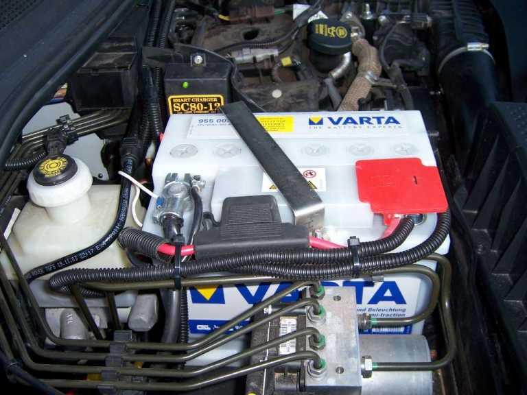

    Here you go Alan, a pic of a 2nd battery installation in the battery box on the drivers side

    Richards is a 80 AmpH Varta. That is the biggest that will fit (as he said needs modification)
