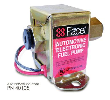

    I'm getting old (so the kids tell me) now - 51, so my patience with these things is slowly increasing. If a facet lift pump is not too expensive I'll go with it, but would that mean I need to bypass the existing lift pump or just install it in the line between the tank and existing pump?

    Ok second time I've seen a facet mentioned what are they?

    its an exceptionally reliable low volume low pressure electric fuel pump, I occasionally refer to them as rattler pumps.
    if you are going to use it as a priming pump you can just cut the line coming out of the fuel water seperator down near the tank and install it there. (make up a bypass hose for the lift pump just incase you need to bypass the pump later on in life)
    if you are going to replace the existing lift pump mount it up near where the existing lift pump is and bypass the pump. I make up a shorting loop to go from the inlet to the outlet of the mechanical pump to seal it up to prevent it from drawing crud in, or pumping oil out.

    Quote Originally Posted by scott oz View Post
    You tend to see them used a lot in small boats and such - very reliable piece of kit.
