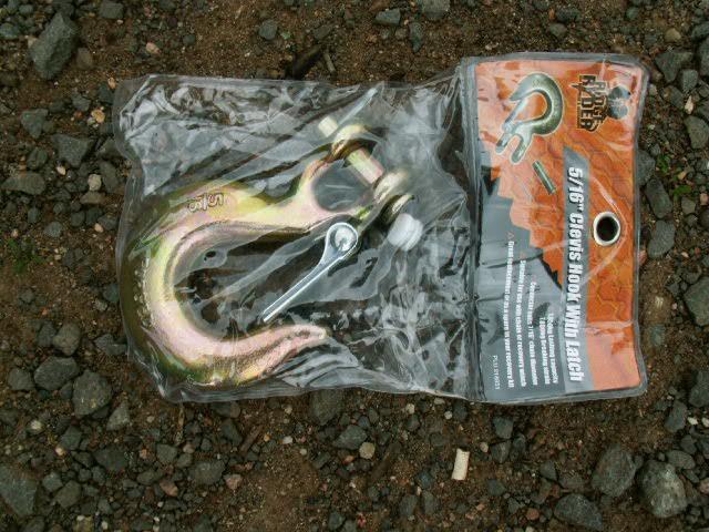

    Found this "Ridge Ryder" hook for $7.00 at Supper Cheap.
    Now most of the cleved hooks( Usualy yellow)for cranes are $45.00+.

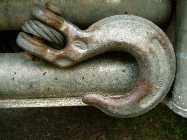

    This is whats on my 8,000Lb winch now, never been happy with it.
    I usualy slip a shackle in the cable and leave it loose(I know) or tape the end.
    So when I saw this hook I thought I'd buy it and have a closer look at it.
    It is the same size as the one on the winch, including the pin diameter.
    Neither hook has any load rate stamped on it, both stamped "forged".

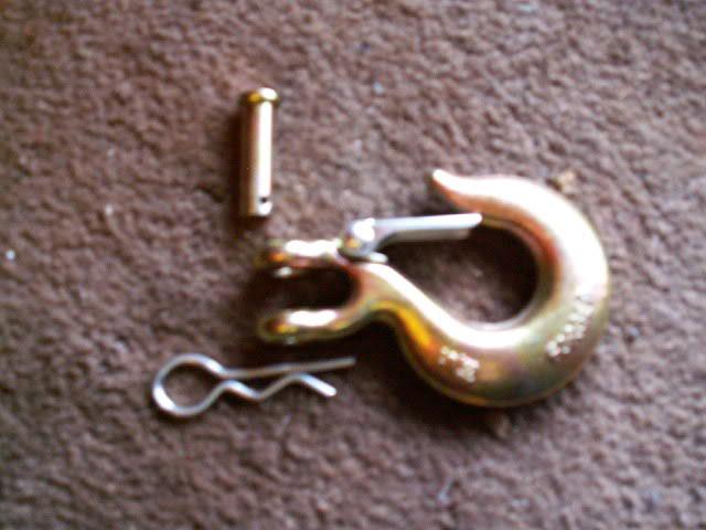

    I was thinking of changing the split pin to a removable pin so I can remove it when I want.
    My idea is to use this hook for single line pulls and remove it and use a shackle for double line pulls.

    G.day Kyle, I'm no expert, but it was explained to me if your shackles and hooks etc. dont have the working load embossed on the shackle/ hook, eg W.L.L 4T, they do not comply to Aus. standards, use at your own risk.

    I would take that hook back to Supercheap and ask what the SWL or WLL is, if they can't show you where it is stamped on the hook ask for your money back and buy a properly rated D or Bow shackle and use that on the end of your cable, if you want to buy "RATED" hooks/shackles etc. go to a rigging supply shop, better quality and more than likely cheaper, Regards Frank.
    18,616
    ARB sell hooks for their Warn winches separately for about $35.

    Looks like a trip to ARB
    Strange thing is the original hook has no load rating on it either.
    Stamped as "Forged USA" and I belive it's the original fitted on the Warn cable
