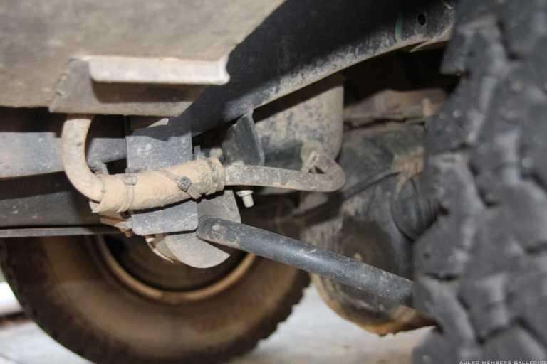

    Has anyone with the Front Runner Aux Tank had any issues with there tank and where or if you have rerouted the equalising line.
    Comments and or photos of modification would be appreciated

    I have one on mine and haven't had any issues at all...well apart from not being able to use a high flow pump at the servo becauses it causes the fuel guage to misread (this is probably not the tanks fault).
    The only concern I have is that the lowest line which I presume is the equalising/balancing line could be vulnerable.

    I will try to get a picture of how I ran my balance line posted over the next few days.
    By rights, as mine does your fuel gauge should remain at the full mark for a few hundred km's until you burn the fuel above your normal tanks height, then go down as normal, but a bit slower than it used to due to the extra capacity of fuel for the same fuel height. Pump flow rates should have nothing to do with your quantity indication.
