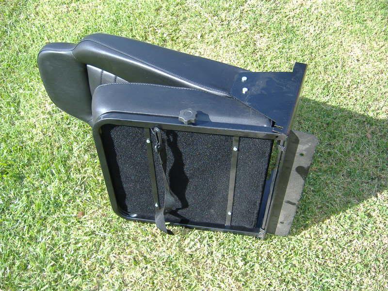

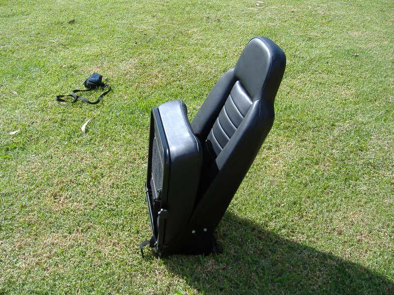

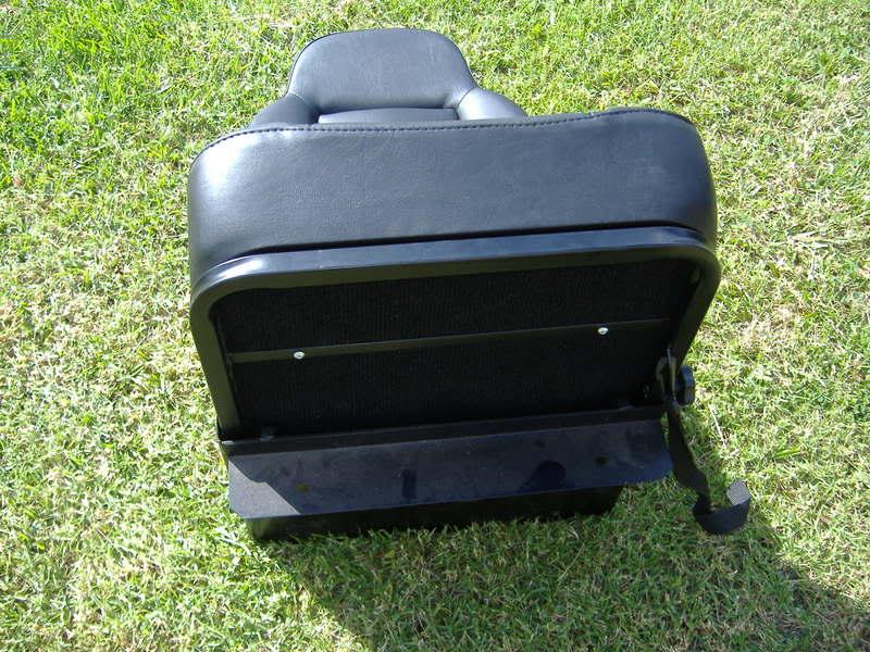

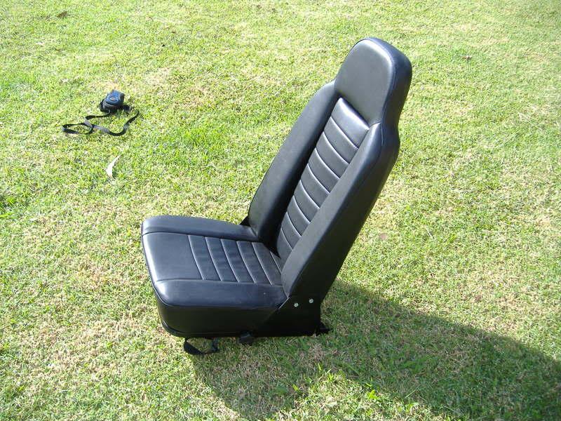

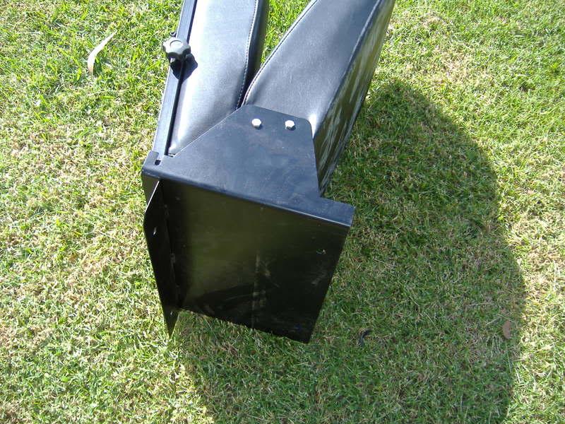

    I have 2 of these.....
    They were imported from the UK.( for use on a 101 landrover)
    They sit on the rear guard and fold up out of the way.
    They would not be legal for seat belt model landrovers.
