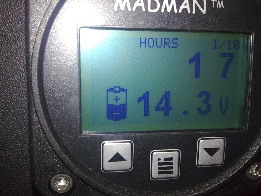

    I have the Madman EMS system which monitors EGT, coolant temp & level, oil pressure, transfer box oil temp, voltage. Everything has an alarm level which you can set and will go off as soon as the threshold is reached.
    It fits nicely on the Puma dash as well:

    Hi Naks, hoe gaan dit my jou? - just to be clear what we need to buy to match what you have - it would be the EMS 2, the long harness, and the Puma kit?
    Total cost excluding shipping is: R3706 - or $512 AUD approximately?
    Iain

    just to be clear what we need to buy to match what you have - it would be the EMS 2, the long harness, and the Puma kit? Total cost excluding shipping is: R3706 - or $512 AUD approximately?
    Iain, yep, that sounds about right. Just be aware that to mount the EMS2 in the dash like I did will mean drilling a hole the size of the EMS2 in the dash!
    You also cannot measure both the transfer box temp and the engine oil temp, I chose the transfer box since coolant temp and oil pressure are already monitored.

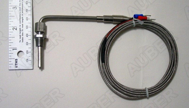

    Quote Originally Posted by Drover View Post
    .......................If so, is the sensor before or after the turbo ?
    There has been a lot of discussion on the forum about where a Thermocouple Sensor should be located, ie upstream or downstream of the turbo. Have a look at this web page for an explanation and other useful info Thermocouple Sensor
    The majority of sensors will be drilled and tapped.
