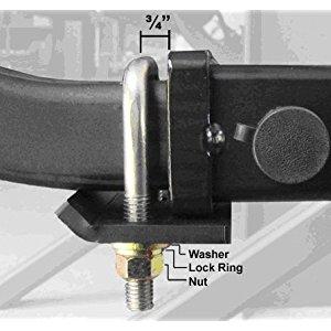

    Ive seen a device I only just located, doesn't look overly complicated from 'StowAway' on Amazon. I'm yet to visit a caravan/trailer joint tomorrow, if its legal in Aus then i'm pretty sure it would be there.

    Hmm, I could make one of those, albeit with the u-bolt inverted and with a plate for the nuts, and a shorter U-bolt too.

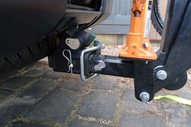

    I use a 100mmx75mm Jockey wheel u bolt (from autobarn etc.) with a flat plate of steel drilled to fit. The u bolt loops over the receiver and the flat plate pulls up any slop when you do up. You can orient it to take the play out in any direction - I use it to pull the hitch to the left or right - if you have something light on probably using it to tighten down might be better. I use it for a hitch mount motorcycle carrier which is pretty heavy and this takes out all movement and it rides well.
    Hopefully this pic works and shows enough to give idea.
