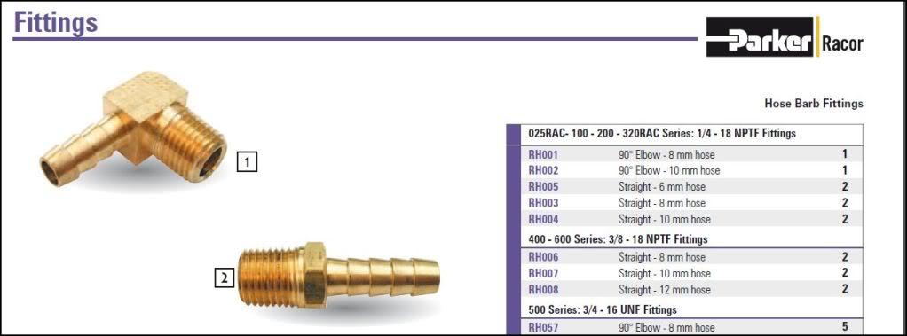

    Spoke to euro 4x4 about the Raccor RA230 and it is not a like for like replacement for the OEM filter housing. Instead it is a separate unit which is added in addition to the OEM filter between the tank and the OEM filter. The parts needed are the filter unit and a couple of Raccor fittings which are easily obtainable. My thinking is 2 x 90 degree barbed elbows and cutting into the tank feed to fit the elbows onto. The only issue is that the elbows come with two hose fitting sizes, 8 and 10 mm. The straight barbed connectors however come in 6,8 and 10 mm. I will have a word with my local LR parts department about the hose diameter and will take it from there.
