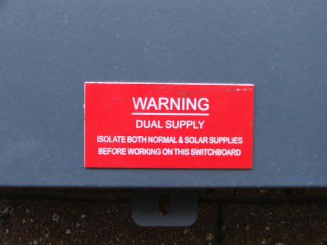

    My cables are strung across the rafters with cable ties (the blue stuff is connected to the aircon ducting). There is no CB on the panels.
    This label on the fuse box is now white:
