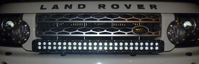

    Purchased a Monster Lights Black 32" bar. A bit pricey but it fits nicely between the headlights without sitting up too high and disturbing the airflow to the radiator. Also throws a nice broad white light.
    Already had the factory spotty mounts that poke up through the bumper so bought some flat bar to mount the light to. Is nice and solid with no vibration. Hooked up the light using the factory harness to trigger the relay in the new harness. Works a treat. Means only comes on when on high beam and can switch off with OEM spotty switch. My Plod will not be able to complain......other than I only have one light rather than two as mandated by our ancient design rules.

    Hi Pete,
    As requested. To quote SWMBO, its too bright, sets trees on the side of the road on fire, and has cars 2kms away flashing their lights. Perfect for the open roads in Australia.
