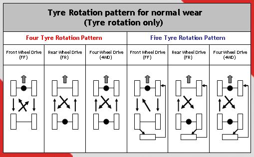

    I wouldn't... Not now.
    Just FYI - I will never rotate Tyres across axles only front to back.
    This renders the spare partially useless.
    I just throw the spare out after 5 years and start again.

    The idea is not to have different rolling diameters across axles but also between axles. Basically you want all tyres in the rotation to have roughly the same tread.
    Having a spare with markedly different tread depth to your running tyres is not ideal - been there My preference in your situation would be to run a 4 tyre rotation until you need to replace, and then get 5 new tyres and run a 5 tyre rotation.
    Hmm interesting - what's your reasoning on that particular rotation pattern? Not challenging, just curious
    I currently use the last one in this picture:
    I'm not a fan of running a Radial tyre one direction and then the other.
    If I ever had need to swap sides I would remove from rim and flip the tyre first.
    Out of interest Tombie, why?

    5,768
    Some tyres have directional tread.
    In the early days of radial tyres, there were reports of tread separation when the direction of rotation was reversed.
    I don't know if it is still considered to be an issue.

    Quote Originally Posted by Yorkshire_Jon View Post
    Sent using Forum Runner
    My opinion (& that of a few people I know) is that the belts are 'aged' by running in one direction.
    Turning them around and running the opposite rotation can make the belts 'flex' in a manner they weren't bedded in on.
    I look at it like running a 4wd stock for 10,000km and then lifting it.
    The unis etc are all used to running at one static height and have bedded in.
    When lifted it often induces a harmonic that wasn't there before, whereas if lifted from new this doesn't happen.
    In the case of a tyre, I have rotated Tyres and had this similar trait before and will no longer do it.
    Drive to Steer and vice versa is my limit.
    Although I rarely, if ever, bother doing that either.
