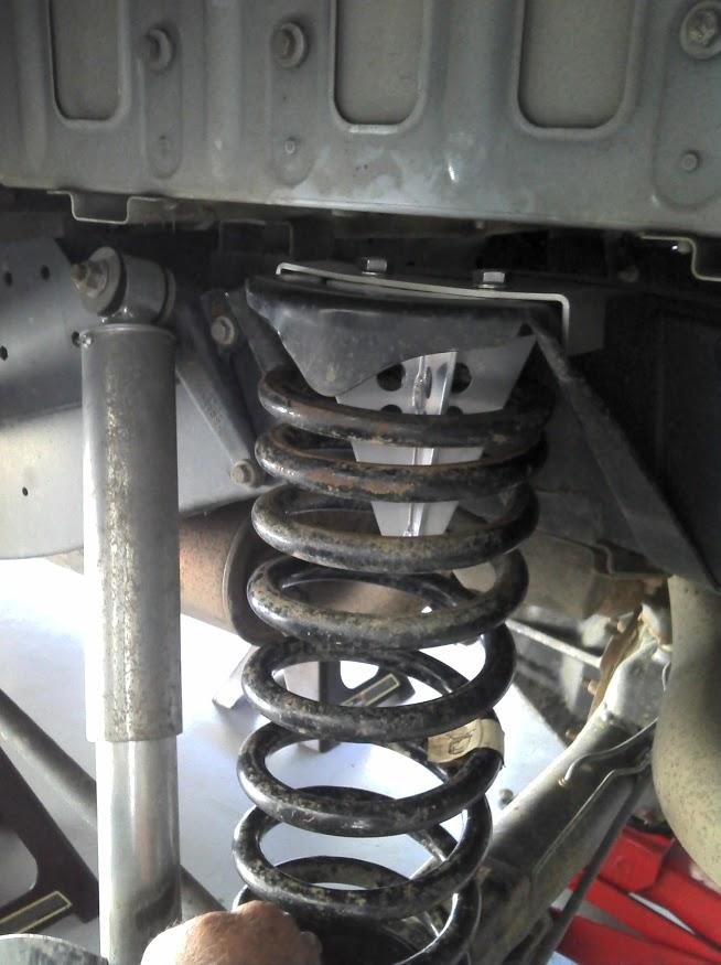

I can't help too much with the detail around dislocating However, I have the +50mm King Springs and air helper bags in the rear, combined with my tough dogs things don't dislocate.
To re fit the bags You will simply need (I'm guessing) a 25-30mm spacer ontop of the axle, inside the coil and below the bag. Frequent dislocating with the bags in place though will lead to premature bag failure.
Needing both does beg the question what do you do with the car to warrent needing the extra articulation from the dislocating springs. For traveling I'd be stopping the dislocating happening and focus on reliability.
