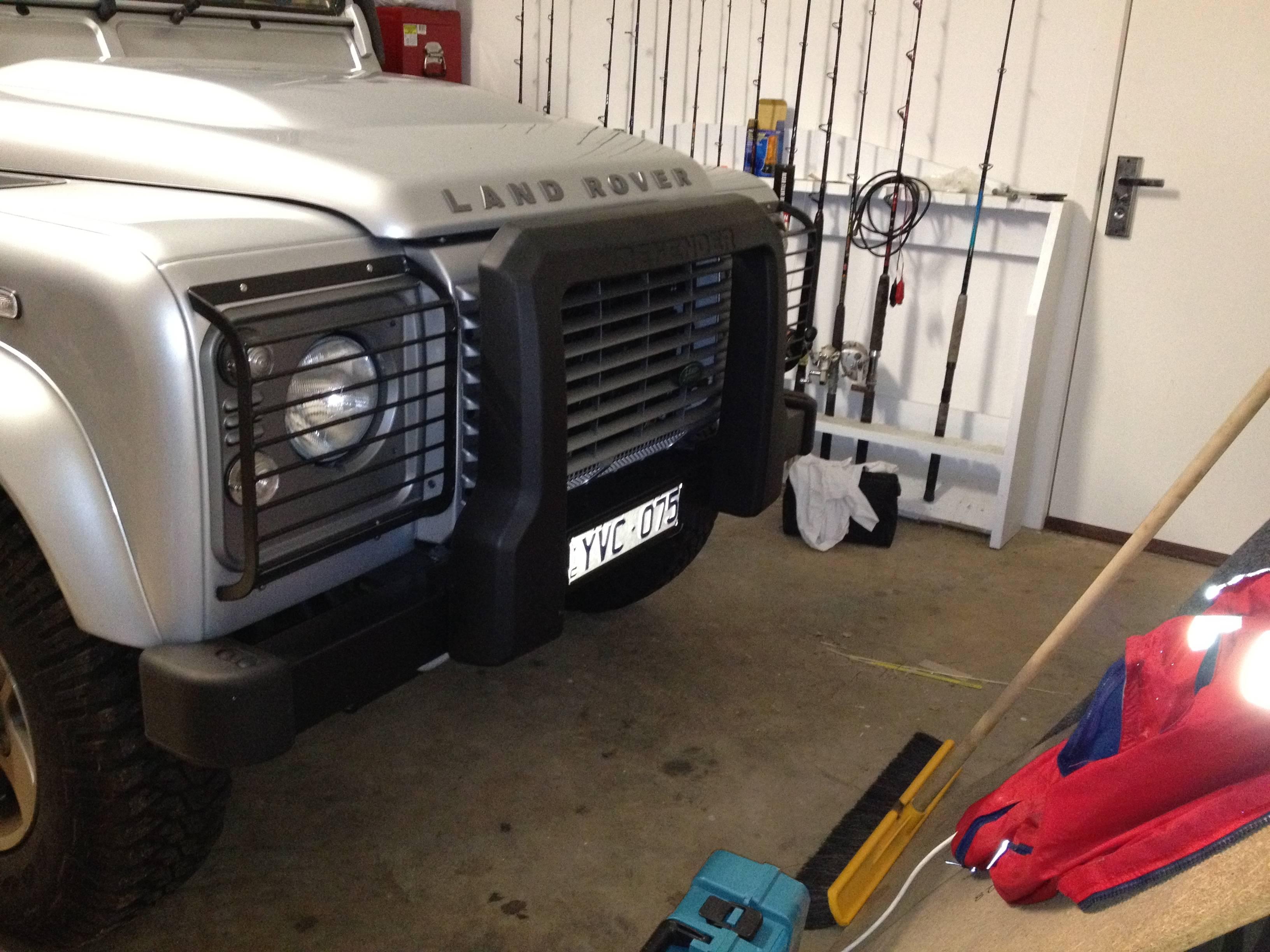

    Hi, my puma 90s has got those factory head light grills and squishy A bar on the front, and tonight I hit a kangaroo on the way home.
    The impact slightly buckled the factory steel bumper bar, and is now pushing on the corner of the car body. I should probably get a decent bar, but are there any bull bars that fit those head light grates?
    Here's an idea of how far it sticks out
    The TJM & ARB website looks like theirs fit pretty close to the body
    Or am I going to have to take them off and have 8 screw holes in the body
    Seems like a waste to pull those bits off - I don't think they're cheap.

    Personally - I'd pull them off, the bull bar will protect the lights to some degree. My experience with those light cages is that they might save a headlight perhaps, which costs about $30 to replace. But any impact damage is transferred to the body instead where the repair bills are several hundred dollars. I'd pull them off, and order some body coloured pop rivets from Land Rover to fill in the holes.
    Near Seven Hills, Sydney
    4,342
    I have what appears to be the same grills on my County, with a genuine td5 era LR bullbar. Before that bar I had a Rovacraft tube style winch bar and had to cut off the bottom couple of rungs and reprofile the lower outer edges of the sides to get any clearance.
    I think the bar will sit around the grills rather than interfering with them anyway.

    I've got the same grilles on the 130, the ARB bullbar fits fine.

    I've just fitted one of the new Land Rover bull bars (which looks identical to the TD5 era bars) and there is a good 14cm clearance to the headlight surrounds. It was straightforward to fit but I had to modify the angled bracing on the brush bar in front of the diff in order to retain it. Sourced from Melbourne City Land Rover who shipped it at no charge. I'm happy with that.

    I've got this - it's a Terrafirma bar.... not sure it's what you want but it will fit with you headlight protectors

    There are no recovery points on the bar itself. When fitting it, I didn't drill the two extra holes in the chassis as suggested in the installation guide. It's the same setup as the bar on my '85 County which is very strong, so I only used the existing attachment points (3 high tensile bolts on each side). Suggest you attach a bridle and d-shackles to the large rings bolted to the chassis if you ever need to have the vehicle recovered.

    I have the new ARB winch bar on my puma with the factory headlight protection. The 2 would not fit on together..BUT, if you trim off the bottom runs on the bar they attach at the perfect height to sit flush on top of the bull bar and line up with the holes in the top, i just then re-used the bottom hinge points to attach to the bull bar.
    There are pics in my thread if you want to see them.
