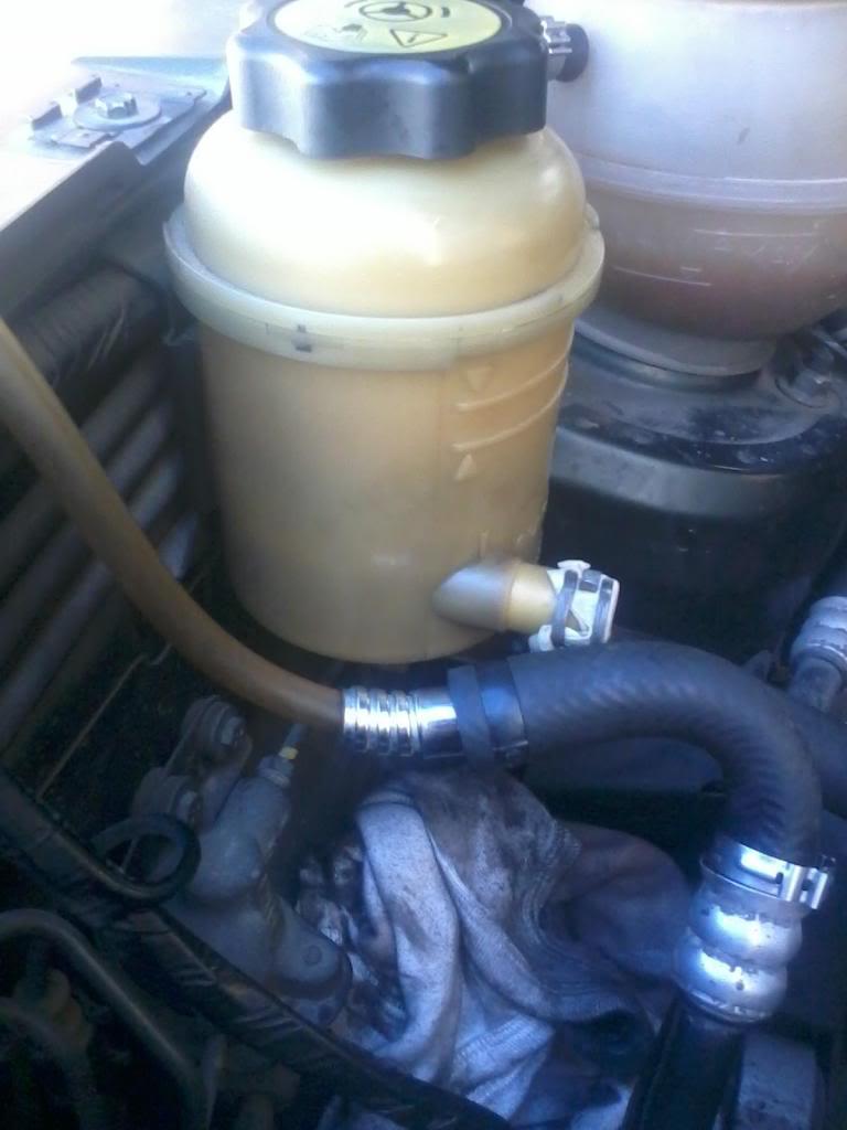

					Hello,
 steering fluid is low and dark, so instead of topping it up I'm going to flush and refill the entire system, this is how I'll do it:
 1- front wheels straight forward on axle stands;
 2- empty the reservoir from top with a syringe;
 3- remove return hose and connect it to a clear drain hose and disposal container, plug inlet pipe so it doesn't spill as reservoir is filled;
 4- fill reservoir;
 5- start engine and turn steering wheel from right lock to left lock and back again (never run engine for more then 10 seconds);
 6- stop engine;
 repeat steps 4 to 6 until you can see fresh fluid coming out through clear drain hose
 7- point wheels forward and remove from axle stands;
 8- reconnect return hose to inlet pipe;
 9- top-up, recap reservoir;
 check for leaks and top-up if necessary on next few runs/days.
 should work but not sure, has someone done it? how much fluid does it take? lots of pipes and hoses...
 Freelander 1; L-Series engine; LH Drive with AC
 thanks in advance
 Miguel Baptista
                                                9th August 2013, 07:25 AM
					it's done, the whole system takes about 1,5ltr and this was the setup
 the only correction to the "method" is:
 -never run engine for more than 3 seconds
