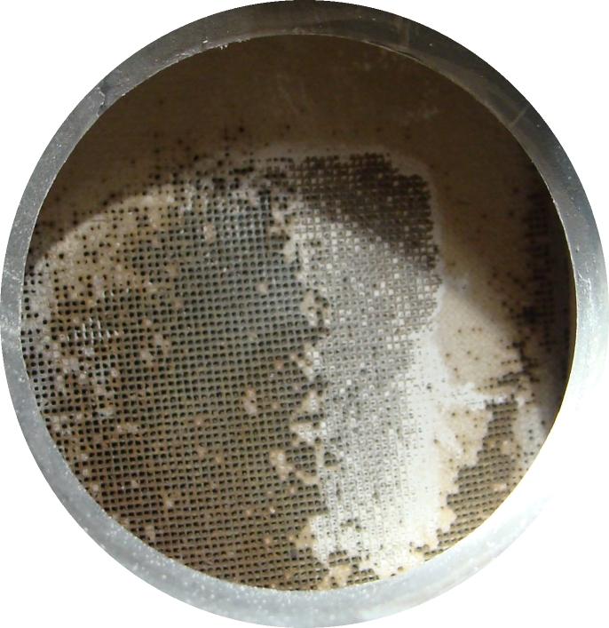

    I've read a few mentions on here of 'drilling out' the catalytic convertor on the Puma engine pipe. Can anyone explain in more detail what this involves? I have no knowledge of what the internals of the catalytic convertor look like, so would like to be armed with more knowledge before removing it to do this. Any pics would be great, but in particular, what does one drill? does it require a large drill to bore material away to the i.d. of the exhaust pipe? or is it as series of holes required to cut something away? I'm planning on wrapping the front pipe with heat shield material and would like to be prepared to get rid of the restriction whilst it's off.

    The inside/matrix of a catalytic converter looks like this:
    http://mkrd.info/uploads/images/audi..._before_sm.jpg
    It is a ceramic matrix with a "wash coat" of rare earth metals.
    .... and worth anywhere from $120 to $350 scrap price, Regards Frank.
