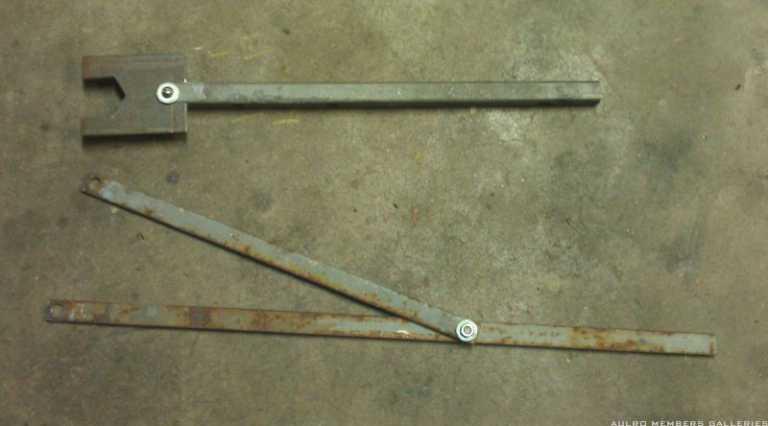

    I'm not sure if the Tdi is the same or similar to the Td5 but this is what I use - the two holes in the lower 'tool' fit over the bolt heads holding the pulley on to stop it from turning. you can do it with two holes in a single piece of flat bar but this makes it fit any spacing of bolt heads.

    Thanks for that. Looks like I need to make one myself!

    blatant theft from another forum member, but i made this based on that person's drawing. I made mine 400mm long to clear the fan
    granted it works on the TD5 and Puma. Can't speak for the 300tdi
