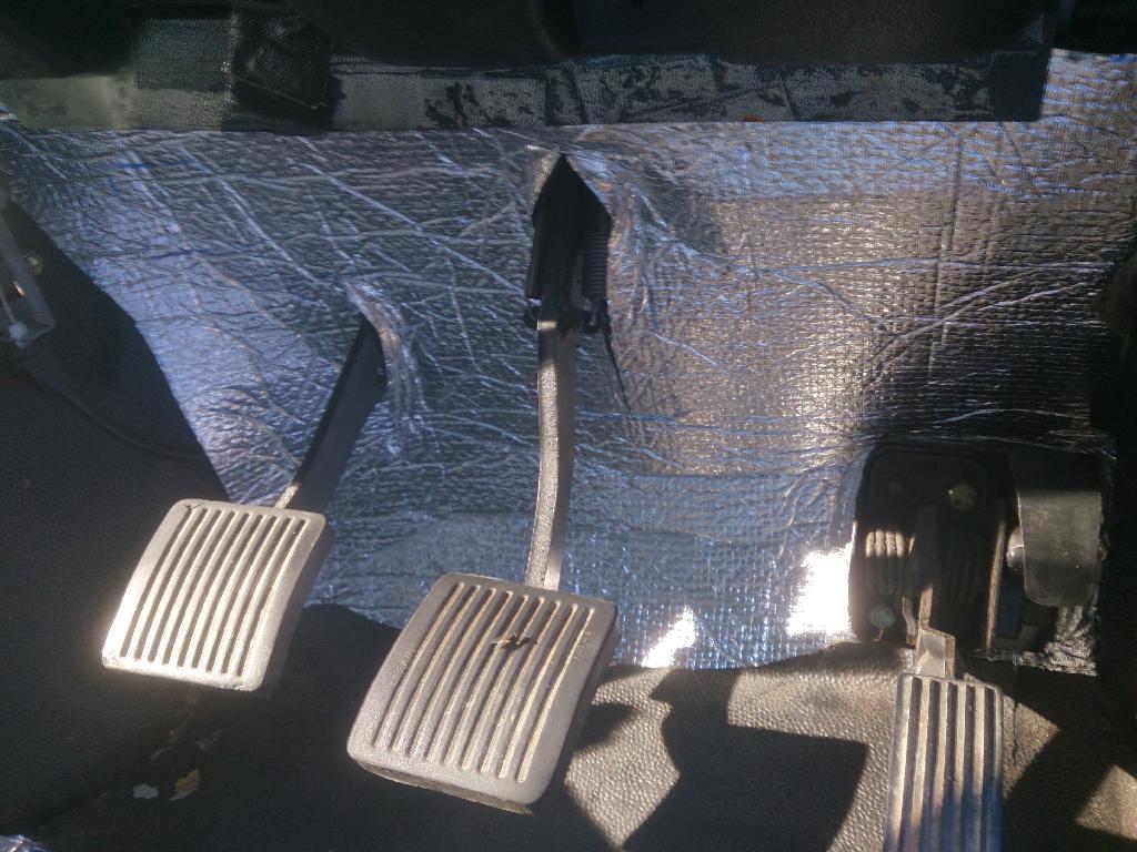

    Hi, just wondering what people had done with the rubber matting that hangs between the brake accelerator & clutch pedals, can you get new stuff to replace the old stuff or is there a better fix?

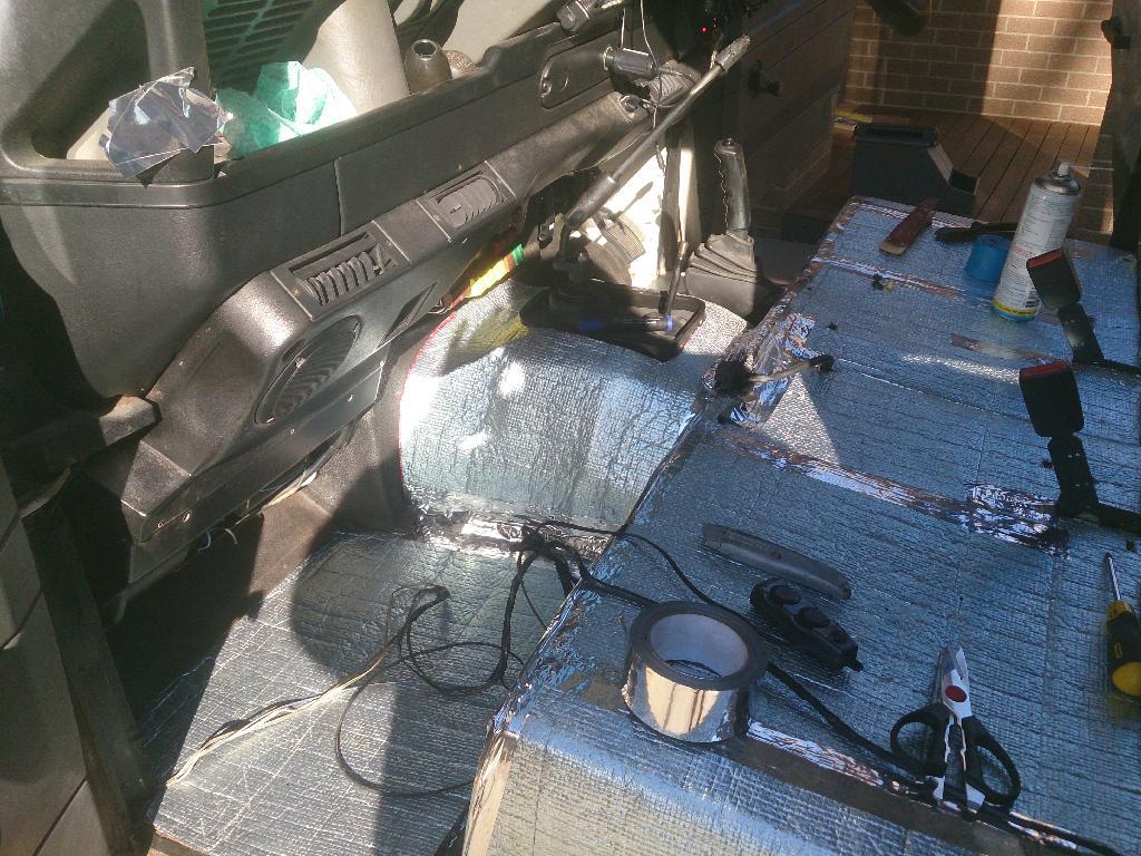

    I used a product called e-therm which is the foil blanket type material used under iron roofing. I snavelled it from a building site and bought a roll of 50mmx 50m alfoil tape from bunnings for $15 and have so far done the whole front interior of the 130. I had carpet in there which I used as a template and have found it works really well. I cut a slit for the clutch pedal and brake pedal. I used to find with the window down I would get a current of hot air from under the pedals drawn through the fire wall making it very uncomfortable.
    I then put the crumbly mat back over everything and the carpet. It took about 12 hours to complete but I also did a few other jobs including adjusting the bias plate on the gearbox and the switches for the door that turn on the interior light.

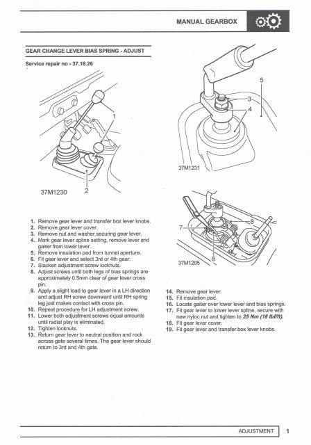

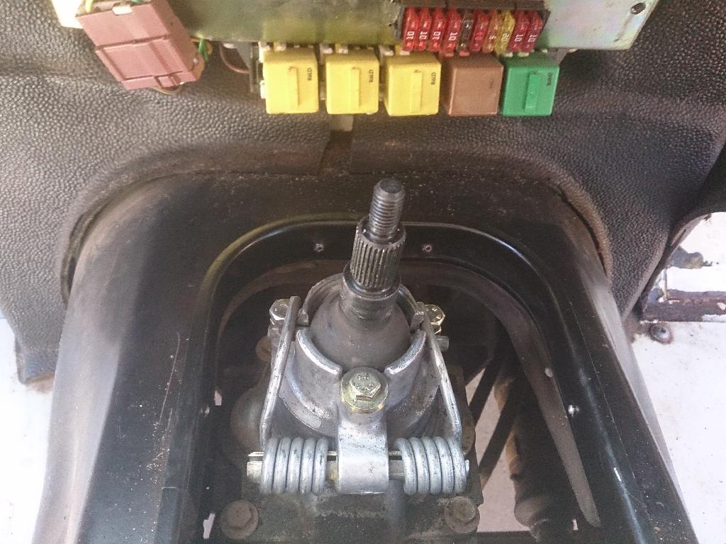

    Adjusting the two 10mm bolts at 9 o'clock and 3 o'clock to get the H Pattern back in the gearstick instead of having to stir it around to find a gear. worked a treat.

    Question How does it handle being wet

    Being wet won't worry this product. You could and I may apply it to underside and firewall in engine bay yet. It will not absorb water.

    I'm also interested to know exactly how the screws need to be adjusted to bring the H pattern back. Are you able to supply any more detail?

    I just used Alfoil Tape. Whilst it won't soak up water it certainly has potential to trap it. I suspect bunnings has it or any place that sells colourbond. The product above looks very similar and seems very cheap. I looked at Dynomat Website but to insulate the vehicle and apply sound deadner was going to be over $2000 if I went by what they recommend.
    Bias Plate adjustment
