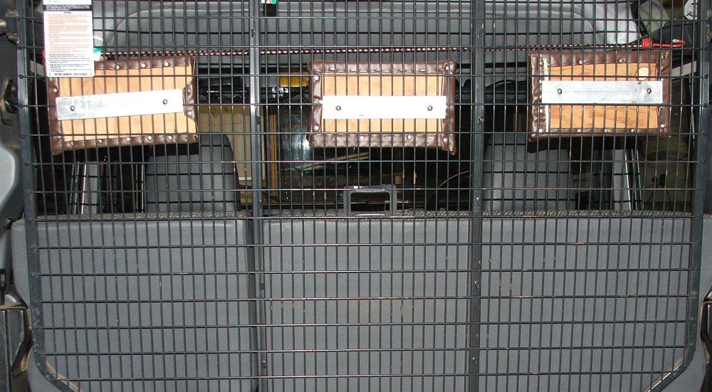

    You used to buy them from milford . I do have a old one but don't know how to do photos on here. It is a piece of ply that has bolts that go through it and then wing nuts hold it through the barrier. It is covered by about 2 inch foam and black vinyl covering the lot.hope that explains it ok.

    I used to have a set mounted off the cargo barrier when the kids were travelling with us (makes me sound old)
    Was just a piece of ply with two bolts through, padding and covered. Secured with a plate of aluminium and nuts.

    I used some camping mat, the stuff you can buy at bunnings, they sell it in packs of four, you only need one, cut it to size and zip tie it to the barrier, it also has the benefit of having hole in it so doesn't obscure your vision when looking over your shoulder/ rear view mirror.

    My better half made a couple of head rests for the kids that could be adjusted depending on whether a child or adult was in the seat.
    She has just finished making a pair for the 80", same thing, hooks through the cargo barrier so they can be moved easily to suit.
