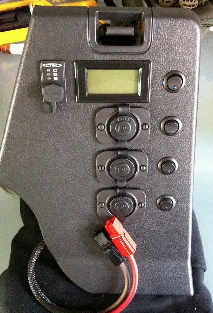

    Here is a photo of a D3 rear panel setup but while I like to give credit to whoever supplies me with info and/or photos, I can not remember who sent this to me.
    I think it’s from the ukd3 forum.
    This is a great looking setup but it still has the potential of the plugs being knocked or falling out.

    Wow, that is quite a setup, but I can't see there still being room for the jack and tools in there behind that, definitely not the tool bag.
