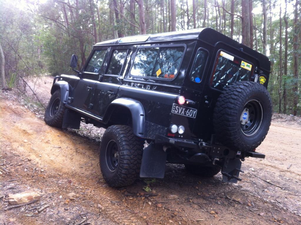

    I took it for a bit of a drive today in the Ourimbah Forest. Unbelievable improvement. So much smoother and controled over small bumps at speed and very comfortable. On the rutted and bumpy stuff it flexes effortlessly with a very soft ride.
    The rear is now 12mm taller on the drivers side and 27mm taller on the near side, the front both sides up 6mm. First time it now sit dead flat.
    Can highly recommend "The Ultimate Suspension", don't waste money picking bits of the shelf. Custom making springs to suit each vehicles individual wheel loads, then matching shock valving to suit spring rates, along with custom length shocks to suit the springs is simply unbeatable.

    Mate that looks sweet.
    I like the new rubber too.
