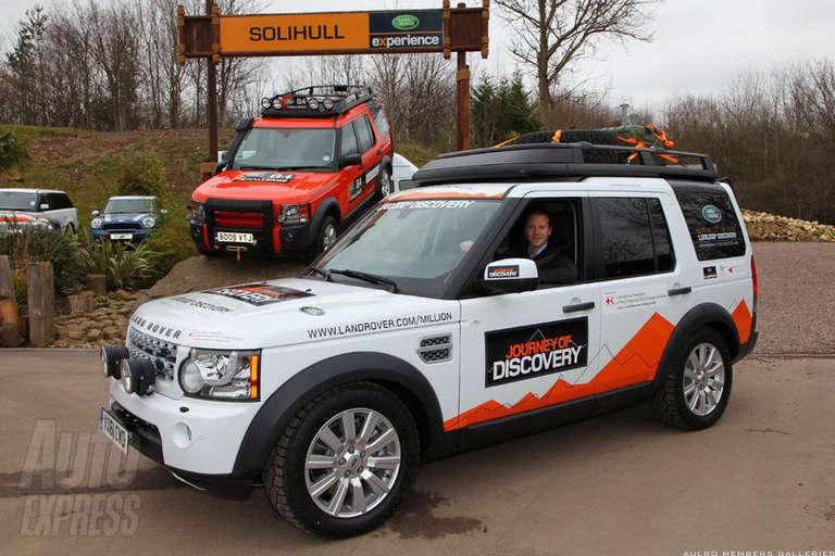

The Duratrac in that size has been around for a while but GY Australia hasn't been convinced that there's a market for them here.
Here's a picture from March 2012..
