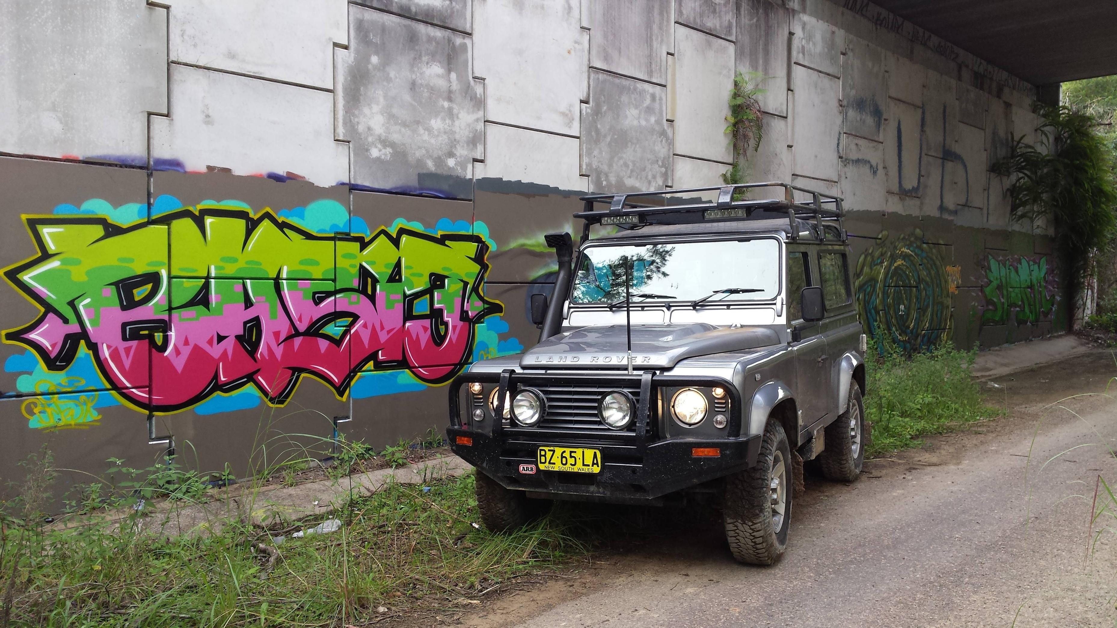

I presented my td5 to Nugget on Sunday arvo and here is the news some good some bad.
Bad news - the Nugget Stuff air box does not fit my TD5.
Good news - the td5 does not need an air box as it's ducting between snorkel and air filter is far less shonky than that on the Puma.
This is based on the safari style snorkel pictured below which has a male tube that goes through the air inlet in the wing to which a flexi tube is clamped.
My snorkel has a hose tail, albeit a large hose tail that protrudes through into the engine bay where a large flexi hose from the air intake system is clamped to it.
I cannot really remember what the original set up was like but I think if your snorkel is like the puma ones then nuggets air box will fit you will just need use a means of reducing from 80mm to the size of the td5 pipe work.
