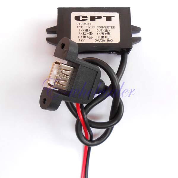

					I wired one of these in - it's a 12v to 5v USB transfomer. And yes, it's a 3A supply.

					Thats a nifty bit of kit dave, where did you mount it ?
 Crawal, I was going to keep my ciggie lighter thingo as well as the usb socket but there was not enough room in the panel to mount the usb socket because of my aux in wiring (I was quite surprised but there is a big block of 'stuff' at the back of the aux in socket) - not sure if this is because it is an '05 or because it has Logic7.  I was disappointed, but no big deal really as I have four others around the car (one of which has permanent power).  If you're not after permanent power to the USB, then just use one of those usb things that plugs into the socket (you can get ones that will charge an iPad).

					I've got one mounted behind the H trim to power my cheap integrated GPS, and one mounted behind the centre console, where the aux input would probably be on your D3.
 I've got a couple of spares if you're interested.
