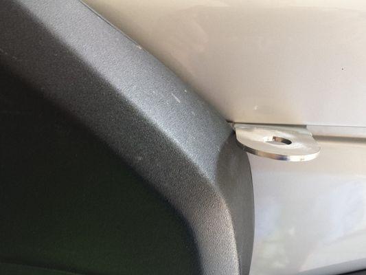

No, it does not clear without some trimming. The bracket attaches on the hood hinge bolt.
I think he would probably be happy to cut one a little offset so it clears the snorkel, it could not hurt to ask.

Yes, I have 2 of the brackets I ordered from the fellow down under. I have the Safari Snorkel. It's a bit bigger than the one pictured there. I think with some fiddling / grinding it can be made to work. I'll take some pictures if it helps.
To make it fit, it will have to be modified, here's a picture. My suggestion would be to manufacture it with an "offset" which will require more fiddling / work. If you talk to him, maybe once he has it sorted he'll send me one that works.
