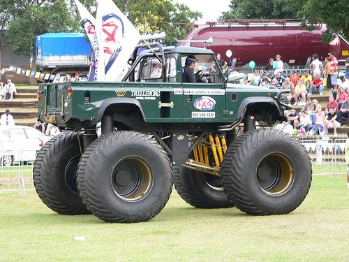

    These were 39.5's I think, although our young fellow went to 44's You did ask what is the largest!

    Lovely stuff. What was done to strengthen axles etc? Swivel pins? Axle tubes? Draglink? TREs?

    I doubt that there's any land rover running gear in that beast.
    I'm tipping it has full patrol running gear.
    I want one!

    Quote Originally Posted by noogie View Post
    I want one!
    That makes sense and is more believable than 44s on Rover axles...........
    I want one!
    3.9 V8 with a ZF auto / LT230. Yes, the front and rear diffs are Hilux - no lockers, this is the former 'Lockless" , preventing wheel spin with an ABS type system, allowing for half decent steering without lockers, with heaps of other mods - hydraulic steering, VN fuel pump, ............ (not mine but Andrew's vehicle)
    Was being converted to 4 wheel steer, worked 4.6, ............ and then a family came along so the Mog diffs and 44 stickies were sold on.
