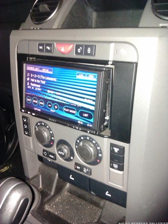

					Cheers Rob. Very helpful. Anyone got any pics of their installs?
 Ben.

					Here's a couple of the Sony DVD install in my D3. I also installed an amp under the driver's seat and upgraded the speakers... a Vifa PL18 mid-bass and a Seas tweeter, with a custom crossover. Way better sound than any other D3 I'd heard.
 Steering wheel stereo controls and PAC SW-I installed:
 Sony DVD player:
