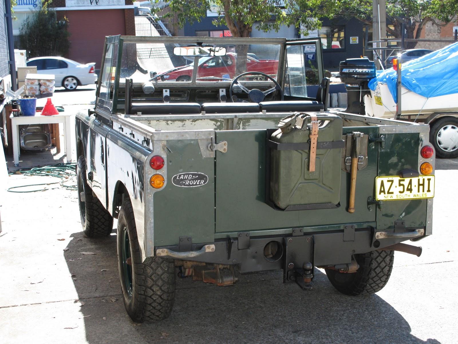

    In 1958 the Series 2 was introduced. Before that, they were only Landrovers, and all Landrovers before Series 2 were retrospectively called Series 1. (the easy to spot difference is as the photos show)
    There is no such thing as a Series 1a, but seeing that it is only an informal designation anyway, I suppose you can informally call a later model Series 1 a 1a, for example 88 rather than the earlier 86 or 80.
    My guess however is that what is really meant is a Series 2a, although that was not introduced until 1961. There is no easy to spot difference between the Series 2 and Series 2a - the only sure way is to look at the chassis number, which has no letter suffix for Series 2 and has a letter suffix (A-H) for Series 2a.

    Quote Originally Posted by incisor View Post
    easiest way to tell is...
    if it has flat sides it is a series I
    if there is a 50mm bulge on each side just under the top of the door bottoms then it is series II
    Interesting adapted tail gate on the SII/SIIa
    oh that rear could belong to a sIII also...except for the hinges on the front door and the individual wiper motors...
    May 2008
    Bundaberg Qld
    7,036
    Quote Originally Posted by digger View Post
    or the steering wheel, or the dash, or the door windows or
