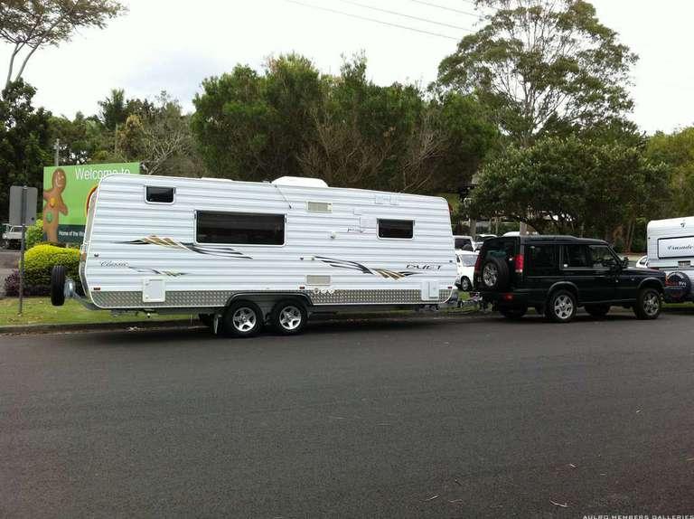

    This works well, http://caravansplus.com.au/catalog/p...ducts_id=11260 and can be used without a WDH system. Needs the thick plate to be welded to the tow tongue. I'd also suggest welding the drawbar plate on too. I have first hand experience with this particular unit, and found that it helped a lot when driving in the crazy winds around the SA border near Casterton. I towed this:
    And if you want some real fun, especially with "truck effect" try this one instead (yes I know I'm nuts):
