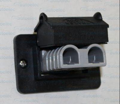

    You are correct. The original white plug on your LR will be surplus to requirements once you have fitted the Traxide kit. I have exactly the same setup that you are going to install in my D4.
    I was thinking of removing the LR white plug and installing the Anderson plug in that position using an Anderson Plug housing (shown below), but am now thinking of trying to find a spot where I can cut a rectangular hole in the bumper and mount this housing / connector so that it is accessible from "outside" (I quite often use the Anderson Plug on the rear of the car when I am not towing, so would like to be able to access it without removing the cover panel in the bumper bar).
