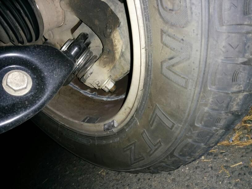

    My D4 had a problem today. Upon braking there was a loud rattle from the passenger side and strange brake pedal feel. Stopped the car, and there was nothing underneath to cause it. Then I noticed the caliper shift. Upon comparison to the driver's side, it looks as though there is no clearance between the wheel and the caliper, which makes me think the caliper has come loose.

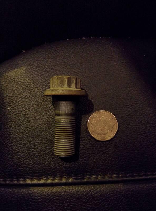

    NRMA had come and indeed found loose bolt and removed by hand. The calliper has scraped and damaged inside of the wheel rim.

    I'm glad to report that this has now been fixed. The bolt was replaced with locktite, and all other brake callipers were also checked. Unfortunately the other front calliper bolts were also far too loose (and now tightened).
