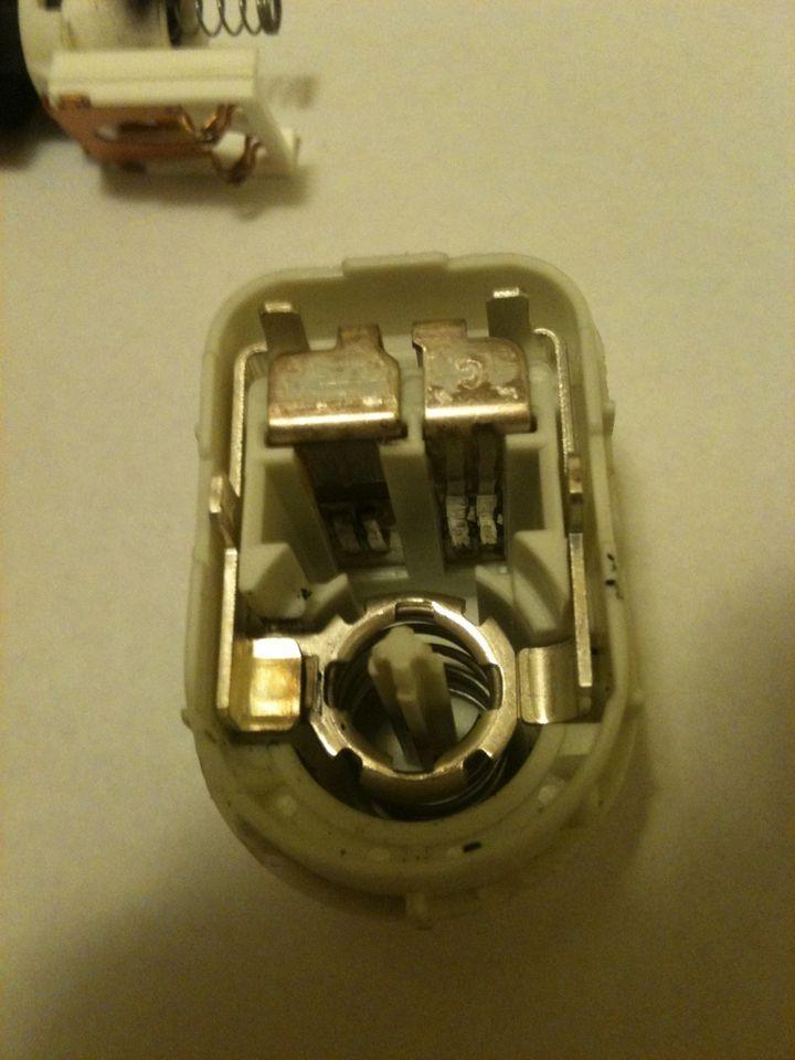

    Went to the Ford dealer and picked up a brake switch $27.20. The SZ Territory has the same switch , and several of the falcon's have the same switch.
    Replaced the switch today and opened the old switch up but couldn't see anything obvious.
    Cheers Ean

    Quote Originally Posted by Ean Austral View Post
    What you can expect with a failed one ..... copied & linked from Disco3 (bbyer):
    "When you take the old one apart, you will probably see carbon dust from a failing contact."

    Ean Austral Guest
    Yep that's what they look like inside , I didn't really see much carbon but for under $30 for a replacement from Ford and a 5 min job to change it then im ok with changing it out after 8 yrs and eliminating that option of my trouble shooting.
