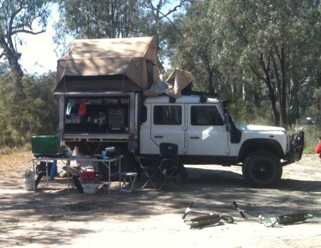

    The only issue I can think of, is if you work in the city and you have to use underground car parks you might find the height an issue. As a rule I just never even attempt to us a covered car park but my 130 is lifted and has taller tyres.
    Here's a pic of mine camping but just imagine it without the tent. You could fit a lot of gear in the rear pod.
