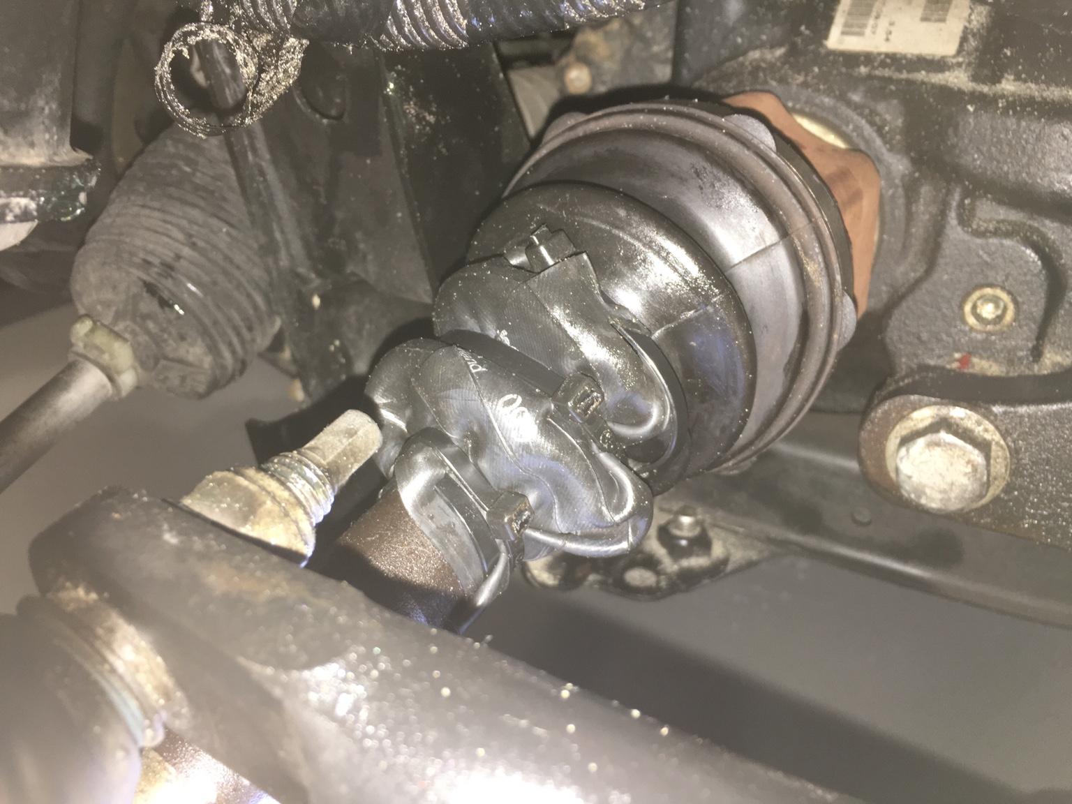

Anyone had to repair a cv boot? One of mine inner front is split. I have packed with grease and used the bike tube and cable tie fix seen on YouTube. Is holding well. I'm thinking to do fix at next LCA change.

						Subscriber[QUOTE=PerthDisco;2608119]Anyone had to repair a cv boot? One of mine inner front is split. I have packed with grease and used the bike tube and cable tie fix seen on YouTube. Is holding well. I'm thinking to do fix at next LCA change.
Good fix , but yeah as I said hardest part is separating CV from shaft ( if its not off in 3 or 4 whacks your in for a hard time)
( unless you have a press )you should get a new circlip as well as new grease
Yes Discorevy, I have repaired a split cv boot. Happened at about 80,000 Kms, now up to 230,000 Kms. Was only done as a temporary fix but after 5 years I guess you could call it permanant
My split was a radial one close to one end of the boot, so not much flexing.
First carefully clean outside of boot with metho to remove all traces of grease.
Then apply Blue Maxx silicon in thin layers, allowing to dry between applications so as to build a complete cover.
