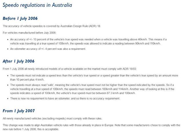

    Australian Design Rules require that the speedo in all new vehicles read "safe" - that is, the speed must read greater than or equal to the true speed of the vehicle, by an amount not more than 10 percent plus 4 km/hr.
    So in answer to your question - the speed indicated on your Hema HN7 is far more likely to be correct, subject to the accuracy / limitations of any GPS device.

    4km/h difference ..... not faulty, that's exactly as per Brian's post.
    Did you read the regulation he posted?

    Quote Originally Posted by BMKal View Post
    Interesting point that "There is now no requirement to have an odometer"

    Yes, the speedo regs that Brian posted are spot on with regards to my D4 speedo - conservative by 4km/h. Will just have to mentally just my conscious to 114km/h down the Hume Hwy from now on
