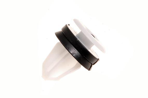

    No kit that I'm aware of but here's a few of the key ones:
    Panel under Steering Column - FYC500040 (can end up inside centre console but usually retrievable. Also used in other locations)
    Door Sill Metal Clip - IPN500090 (usually can retrieve with magnet tool)
    Rear Light Plastic Panel & B-pillar Lower Panel round plastic plug - EYC106710 (very common)
    A-pillar kick plate round plastic plug - LR013135 (Also used in many locations)
    Windscreen Side Trim Clips - LR026343 (kit that should only be bought genuine and always replaced if trim lifted)
