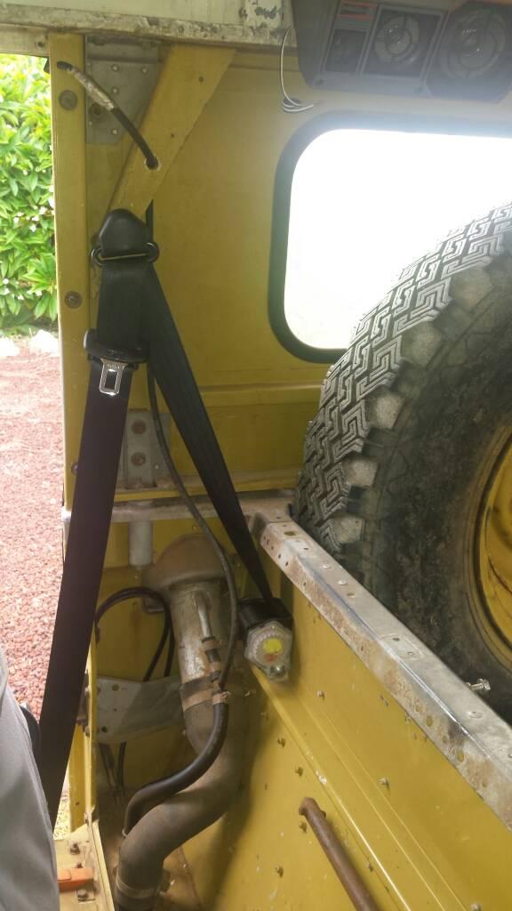

    Check out ebay seller..redss101. He sells seatbelts for holdens and its what i fitted to my s3 drivers side. I cant remember the number but it fitted great. I bought the one with the longer solid stalk coz im a fat bastard but its up to you what or if you buy anything.
    Cheers Rod

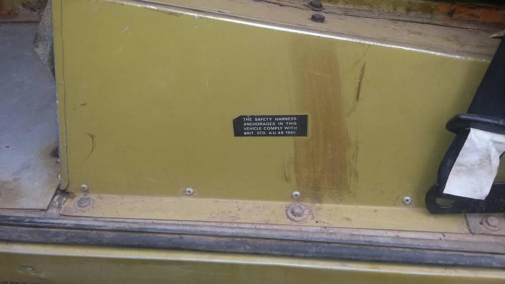

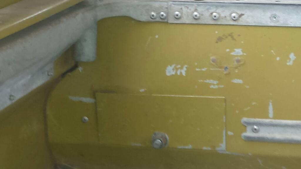

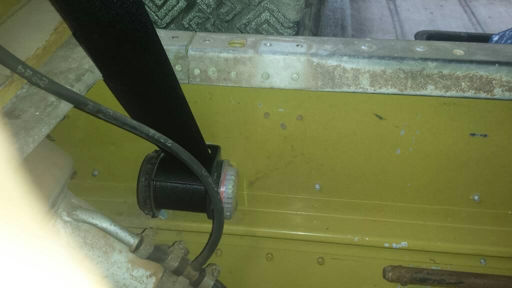

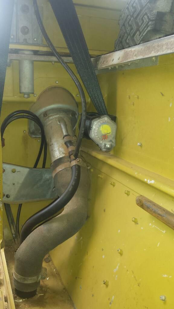

    Rod,
    I see you have overcome the Holden belt being shorter by relocating it higher up, Could you post up a pic of the bracing behind ?
    Apr 2014
    Blair Athol, Adelaide South Aust.
    2,745
    Hi Deejay, thats the standard mounting place for s3 inertia reel. All i did was unbolt what was there and bolt in the new belt. I do have a pic of the brace. Its just an aluminium plate spot welded behind the tub. The plate is the same thickness as the rest of the tub, so its basicly double thickness where the reel part is bolted on and fixed with a bolt and nut and of course washers.
    I hope this clears it up a bit for you.
    Cheers Rod
    Ps you need to get the seatbelt to suit a sedan with bucket seats so u get the hard stalk. The stalk comes in different lengths. I got the longer one at 45cm but i have commodore buckets fitted to my s3.
