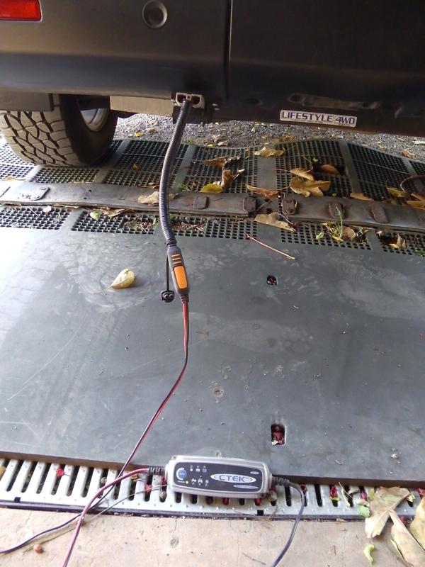

    I have also needed to top up the battery charge on mine since I have stopped working and don't drive the vehicle anywhere near as much as I used to. Must admit though that I have never got any message on the dash telling me that I needed to start engine to charge the battery - I simply notice the longer / slower cranking, especially in cold weather, and put the vehicle on the charger about once every couple of months for 24 hours or so.
    I have three batteries in mine - the OEM cranking battery, plus an Optima yellow top under the bonnet and an Engel battery pack in the rear which runs the fridge - both auxiliary batteries are connected through a Traxide system.
    I re-located the rear anderson plug to outside the bumper, mounted in a housing with a spring loaded cover (saves me having to remove the panel in the rear bumper to access the plug when I am charging batteries / powering LED camping lights or compressor etc). I simply plug my CTek battery charger into the anderson plug - it charges all three batteries in the vehicle, usually in less than 24 hours.

    I've got a pretty old (and basic) one - it's a "Multi XS 3600". Bought it at one of those 4WD shows in Perth at least 7 or 8 years ago. It has never given me any problems so far.
    My son has a newer model with a lot more features - but I couldn't tell you which model it is. I have also used his on the D4 with no problems.
