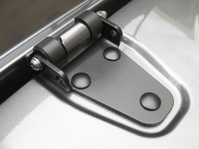

    Has anybody got aftermarket hinges on their defender (puma) bonnet. Im sick of the rattle going through the fire wall on really rough roads that I travel everyday.Ive tried rubber seals on the lower bonnet edges, but these rub the top guards paint. Its a crap design that should have been left with the series III!

    Is the rubber on the hinges still in good nick?

    I got sick of the bonnet rattle on my Tdi coming down the Tanami, so I purchased a set of these some years back. Absolutely no rattle now. They were expensive (about $180 at the time) but have been so worth it. I just got back from a 10,000km trip through Botswana and Namibia in a Puma and was reminded of the bonnet rattle I once had.
    Mudstuff have them for $144AUD at the moment Defender Bonnet Security Hinges
    Defender Tuning in Australia used to sell them too, probably still do, I just googled the image and the mud ones came up first.

    Thats awesome, exactly what I was after, I figured someone else had the same problem..

    There should be rubber buffers on the firewall that the bonnet comes against as it closes. These stop the rattle. I had to glue an extra layer on mine as they barely touched.

    I have one and recommend it. It is actually a nakatanenga product
    Anti-theft bonnet hinges | Nakatanenga 4x4-Equipment for Land Rover, Offroad & Outdoor

    The vibrations seem to increase the radius of the bend in the curl over time. I have fixed the same with a rubber mallet.

    I fitted these hinges to my Defender last week and got a very pleasant surprise
    They significantly reduced engine noise in the cabin with the window open.
    Having the bonnet firmly fixed to the body must somehow reduce its ability to resonate/transfer noise.
    I already have the noise killer engine blanket fitted so this was the last thing I was expecting.
    Anyway, no more rattly bonnet and less noise
