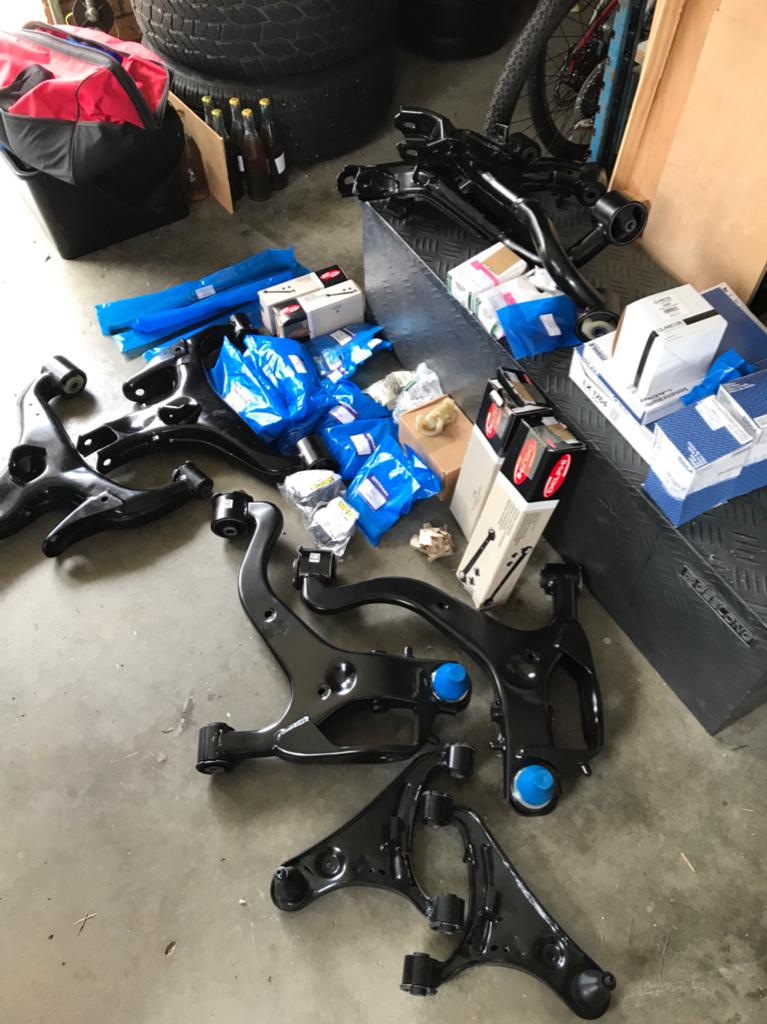

    Well look what turned up 5 business days from order from LRDirect.. would have been here Monday but I guess Santa got in the way Suspension overhaul...Suspension overhaul... .... one box ordered a day later to split order but I guess now the work begins...

    Which set did you order? OEM, Original Equipment, Land Rover?
    I just did mine, including a Hitachi compressor rebuild. Enjoy the front struts and getting to the rearward too bolt! It’s joy.

    Hi DiscoJeffster - I ordered a mix of parts but the arms are OEM - all parts LRD Workshop approved 2 Year warranty (my thought process was it must be a good part) also some LR parts where the price wasn't too far away! everything looks great from initial inspection and the last of the boxes rocked up.. so I have everything now. I did the compressor last year and it has been going strong, doing the valve blocks this round. actually the only parts I haven't done yet are the airbags..

    Ah sorry. I couldn’t see the photo originally and just assumed it was struts you’d ordered. You look to have your work cut out for you with that lot!

    All arrived 5 BU days from ordering! It’s a pile of parts now.. also in the mix - new rear tailgate locks, fuel door lock, bonnet / rear door struts and rear mud flaps.. Christmas present to the disco for all her hard work!
    Pretty excited if you can’t tell. Hahaha. Suspension overhaul...

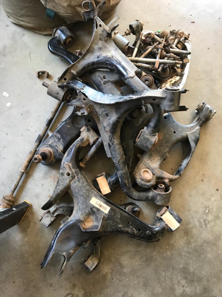

    Finally got a day to finish it all off! All up two and a bit days with a heap of other minor repairs to locks and worn parts. Off to a 4 wheel and steering alignment tomorrow - cant wait to feel the ride.

    So was that every arm and bolt replaced, plus ????
    Massive amount of work there.
