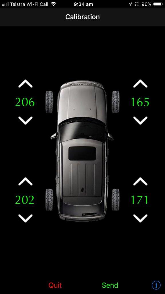

    FWIW, here's a screenshot of my current values, yes, there is a big variation across the rear.
    Car is parked on a bit of a sideslope and I was not in it.Screenshot (29 Dec 2017 10_28_54).jpg

    The 'Calibration Value' is the fudge factor that i referred to in the other thread. Mine was the same, it appears that someone cranked up one side, so that side is doing all the work. There are a number of other variables but for now just pay attention to the procedure I detailed, and dont delete any steps.
    But the 'seat of the pants' test is the speed hump test (in the other thread ) and if one side wallows down, in your case the right rear, then it would confirm that the left strut is doing all the work, hence tyre wear.
    Anyway, you have your 'as found' figures so if you get lost in the process just put those calibration constants back in and have a rethink, or start again.
    But as Tombie mentioned, lotsa round-abouts are another factor, but from your as-found calibration constants I reckon this now needs a better look at as well.

    Well you know I’d not considered that one side might be propping the other but now looking at the values that I have from the last guided calibration, that might be my issue too. I’ll do as you say and reset them all to 190 odd, then take it for a drive to settle it, then run through a guided calibration and see what it comes up with.
