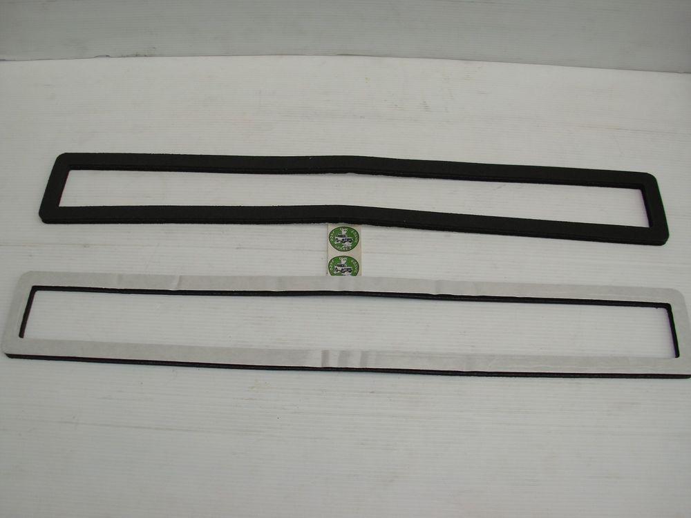

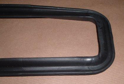

    If the rubber seal is the problem why would you file the vent down ? Sounds like you need to find an alternative rubber sealing material.
    The original was a moulded profile.
    A few companies have sold a stick on version that sticks to the vent. Looked more like a sponge rubber than moulded rubber
    I have some aftermarket moulded seals here but I'm not in a position to fit them at the moment. From reading others experiences you maybe need some external force to get it to close initially but over time the seal deforms and becomes easier to close against.

    The ones in the bottom picture look more like Series 1 seals.

    Quote Originally Posted by B.S.F. View Post
    .W.
    Listed as Defender seals that stick on the inside of the vent. Local LR supplier was selling these for some time as replacement for SII & SIII, probably because of the problems fitting the standard seals.......
    As for Original, Genuine, OEM, OEM supplier etc etc. .......What do the manufacturers actually mean ??
    When did Land Rover stop Series III production ? Are they suggesting that the 'original suppliers' are still making parts for the spares market ?
    Genuine/Original
    They are 'genuine' type i.e. look like the original but probably inferior materials and incorrect dimensions.
    OEM/OEM supplier
    The company that makes them are an OEM supplier to some car manufacturer somewhere in the World (but not Land Rover). Again possibly inferior materials and dimensions a bit hit & miss.
