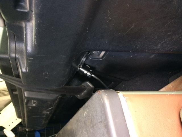

    Here is my setup,there are two sockets,one cig,one Merrit,Traxide kit.
    I don't use the cig very often,the Merrit is used all the time for the fridge,also the spotlight.
    It has never come lose or fallen out,over 5 yrs of travel.
    I have a bit of wood(can be seen in pic) between the old Engle and the wheel arch,so i can put things there,but it isn't needed.Even with the fridge pushed right up against the wheel arch,the merrit plug is fine.I also have a switch in the cord going to the Engle so i can turn it off for whatever reason,without pulling the merit plug out.
    As for merrit plugs,and sockets,only get good quality ones,i usually use Narva,there are cheap chinese ones around that are garbage.
    Apologise for the pic on its side,seems it doesn't want to turn around,bloody phone pic......

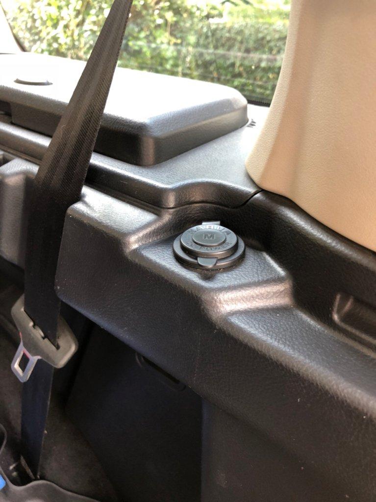

    I followed Tim’s advice above- this is the position of the socket
    Works perfectly for me as I have my fridge set up on that side.
    Pic with the plug (reinforcing point about quality plugs above - this cheap plug was a bit unreliable and has since been replaced with a better Narva plug) in:

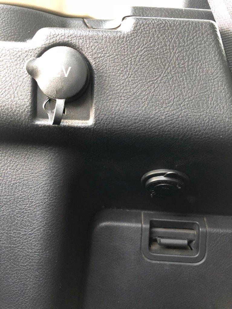

    I’ve also mounted one on the other side but under that position:
