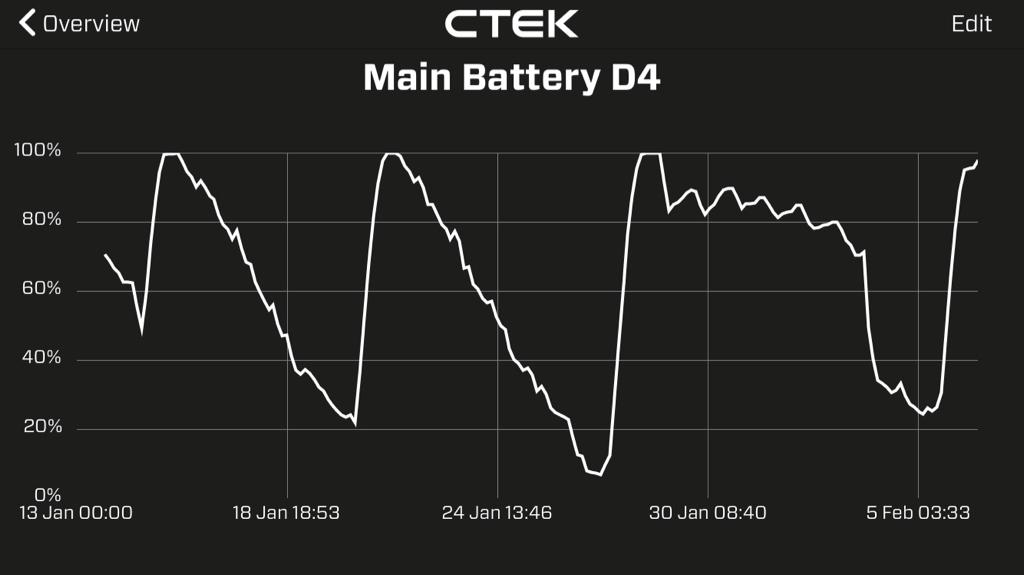

    No worries Rich. The only reason I have that photo is that battery was a replacement installed under warranty last year.
    My car mostly does short runs and the original was giving low battery warnings all the time. Dealer tested and replaced. Admittedly I could be more diligent charging it too.
    I recently left my car idle for about 6 weeks (couldn’t drive- shoulder operation) and then the low battery warning popped up. No surprises there. It started ok but now I’m trying to rejuvenate it by charging. Not sure if it will work or not.
    I’ve installed the Ctek battery sense monitors and this is the battery capacity/voltage graph from the app. The sharp upswings are charging with Ctek 5A charger. Will see how it goes...
