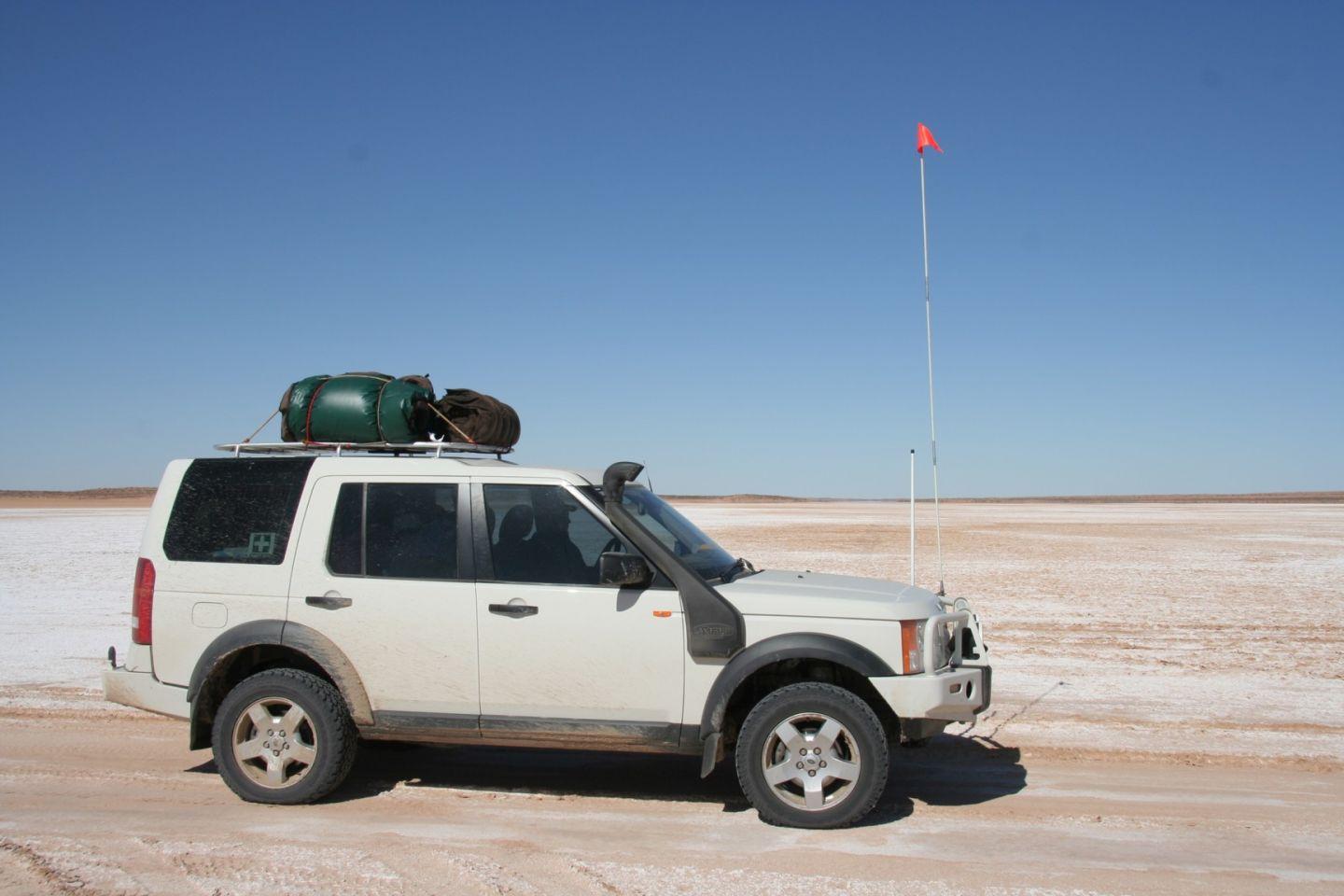

    This is the Safari set-up.

    1,455
    Quote Originally Posted by abaddonxi View Post
    Saw loverly snorkel on a D3 the other day, was so surprised I didn't have time to take a picture or even read the name on it.
    It had some kind of fins or flanges or something to make it go faster.
    Looked the goods.
    Simon
    They are pretty common. I like the look also but have no idea on brand. IF they were a reasonable price and were widely available that'd be my choice on a D3 for sure.

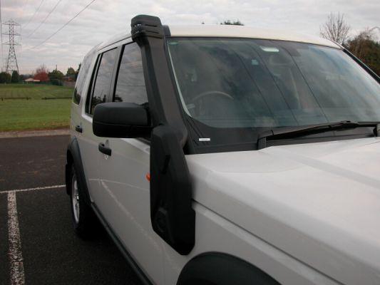

    Here's a pic of th LR RAI. I understand they are made by Mantec for LR. From this angle they look bigger than the G4's angle
