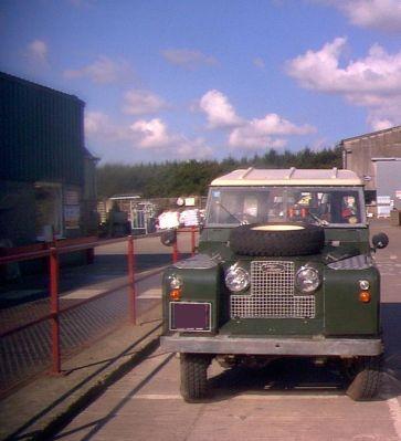

    A couple of comments:
    • There is no point differentiating an 88" from and 86" by the inverted grill, all landrovers from 1952 through the end of the crosseyed series 2a have grills. The S2 and S2a have a cut out for the bonnet catch (instead of the 2 spring clamps.) A better descriptor would be that the 86/107 have 4 airflow holes in the grill panel while the 88/109 have only 1.
    • The 88" bumper is not taller/thicker than the 86" bumper bar, the taller bumper bar change came with the Series 2. The difference is that the 88" bumper has the lower bracket that fits between the side plates for the front spring hanger bracket.
    • Yes the 88"/109" bonnet is about 1" longer.
    • There were tens of thousands of 86" and 107" and the 107" station wagon continued in parrallel production to the 109" right up to the end of Series One.
    • Yes it was exactly for the 2 litre diesel so there was clearance between the axle assembly and the sump.
    • The 88" guards will obstruct the rear of the front wheels when on full lock with 7.00 or 7.50 tyres. You are better off using 80" guards on an 86" as they are basically the same external dimensions. But us rivet counters will know because 86"/107" guards are 3 piece while 80" are only 2.
    The Sereis I has a woven mesh grille, while the Series II/IIA have a weld mesh grille.

    Quote Originally Posted by Aaron IIA View Post
    I look at the rear axles - semi floating or fully floating.
    Aaron.
    AAron
    Your comment about the grill is generally true for Aussie built Land Rovers although UK built Land Rovers had woven mesh grills right through SII/SIIa and even as an optional fitting in SIII.
    Fulling floating axles were available in the 1958 SI but not the earlier 88" & 109" and many have been retrofitted to every manner of SI from SII vehicles. What you can say however semi floating axles are only fitted to SI vehicles.
