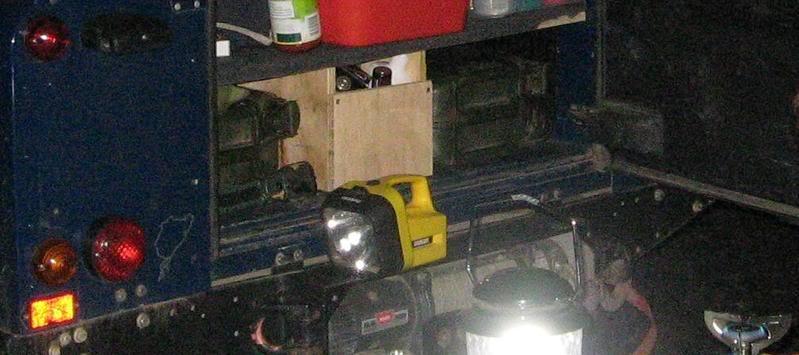

    i cant find a picture at the moment, but we dont have a lot of space so have to pack carefully.
    Firstly we decided we wanted to be able to carry 4 jerry cans of fuel, and I didn't want them on the roof. I also wanted to be able to get to them easily as the back of teh 90 was very full.
    In the end what we did was.
    1. Get a really thick piece of rubber sheet, and lay it across the top of the wheel boxes, down the side, across the lower floor, and then up the other side.
    2. Then I made a floor out of 19mm plywood which sat across the top of the wheelboxes.
    3. Next I got the 4 Jerry cans, and slid them in, 2 each side on top of the rubber sheet.
    4. I then made a drawer, using the remains of the plywood, to slide in the gap left between the jerry cans. This then casued issues, beause of the door check strap so I modified it to be one long drawer that did most of it then a small short one, which could be removed to allow the jerry cans to be removed.
    I put all my tools in the larger section, and things like matches and insect repellent in the small one. The drawer also supported the floor.
    Final step was to trim the floor with some carpet.
    Everything then got shoved in!
    We had the fridge, accessed only from the front.
    The jerry cans didnt leak a drip in 7000km.
    Here is the only pic I could find.
