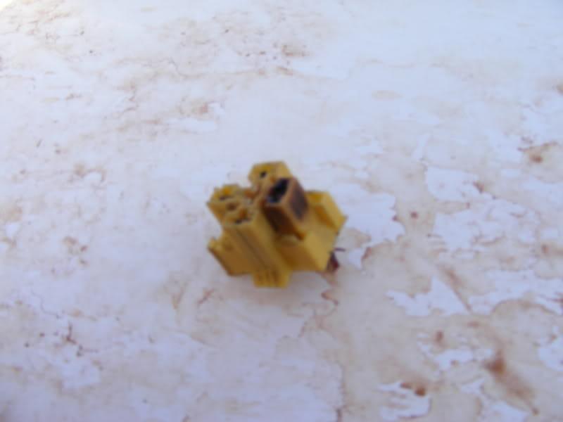

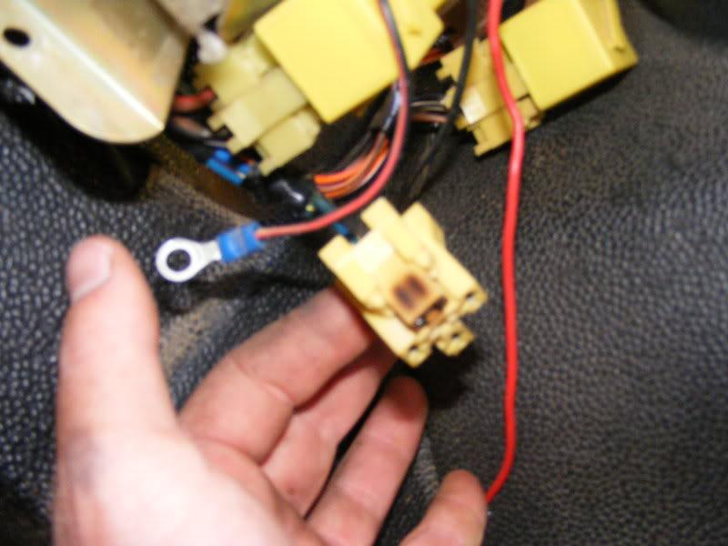

    Check your relay, after I instaled I had some slight difficultys. Found my relay holder looked like this,
    Picked up a new one from super cheep, the relay was still ok.
