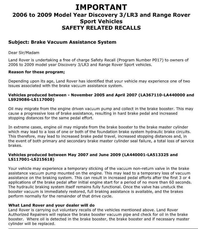

    See:
    DISCO3.CO.UK - View topic - Vacuum Booster Issue- RECALL
    You'll be getting one of these:

    All info from LR here:
    http://www.disco3.co.uk/gallery/albu...ll%20whole.pdf
